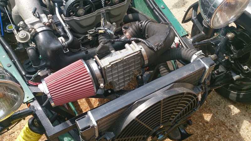

Well back to the IVA stuff. I got a lot off the list today.
One of the things I hadn't fastened properly was the AFM and air filter so I made up some brackets for it.
Not an ideal place I know but it will do.

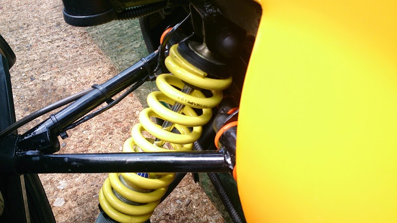

Also my shock tops. As you can see below the way the spring end was was causing trouble. I turned the spring and put a single piece of CV boot corrugation on the top of it. The rest of the spring is fine so that should do it.

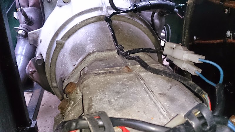

Old 12th July 2014, 10:28 PM
I also had a length of wires going to the gearbox that wasn't secured at 300mm. I drilled a small hole through the rib on top and secured it to that.
