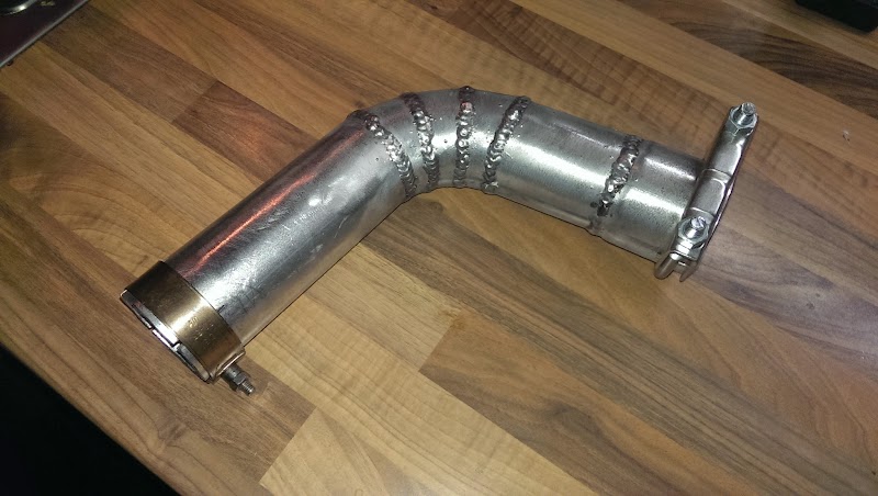

Made up a down-pipe to silencer pipe today.
Its all 2 1/4" up to the silencer then the silencer I have is 2"
Tossing up between cutting open this silencer and fitting 2 1/4" internals or get a full system made for my birthday next year.
Guess Ill see how long my patchwork pipe lasts!
