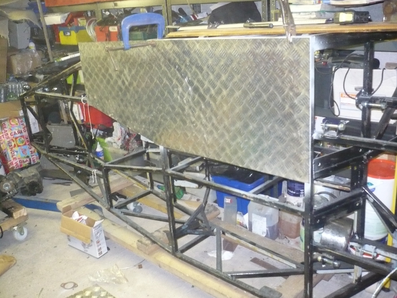

Chassis is now on it's side and the passenger chassis rails have been cleaned up and sprayed ready for cutting the floorpan ( 2mm Ali tread plate ) which I am going to cut down to length and widthish tonight.

Floors Phase 1.
Passenger floor almost cut, just the front side cut to do. I started with the Jigsaw but got a bit frisky and the blade got clogged with fused ali... So I went onto the trusty old Scorpion Repo Saw which actually did a pretty good job.
Only spent about half an hour as it was almost 9pm and don't want to annoy the neighbours.

Looking good TT - I've just cut my floor out and used a 1mm stainless cutting disc on the angry grinder as a few people suggested. I was amazed at how easy and controllable it was to cut the sheet. I'm actually looking forward to cutting the rest of the panels out

Clecos turned up, was going to bring the rivets , seal and drill bits back from work but I got stuck for 4 hrs trying to recover the e-mail of a user who deleted it ( we normaly don't bother ) and by the time I left the office the roadster bits slipped my mind.
But I had 1 4mm drill bit, so I have made a pilot Jig, it's only got two pilot holes at present I will add a few more to save having to move it over and over. And with that I have drilled 3 of the 100 Passenger holes and put in the wonderful Clecos... YAYA!!
