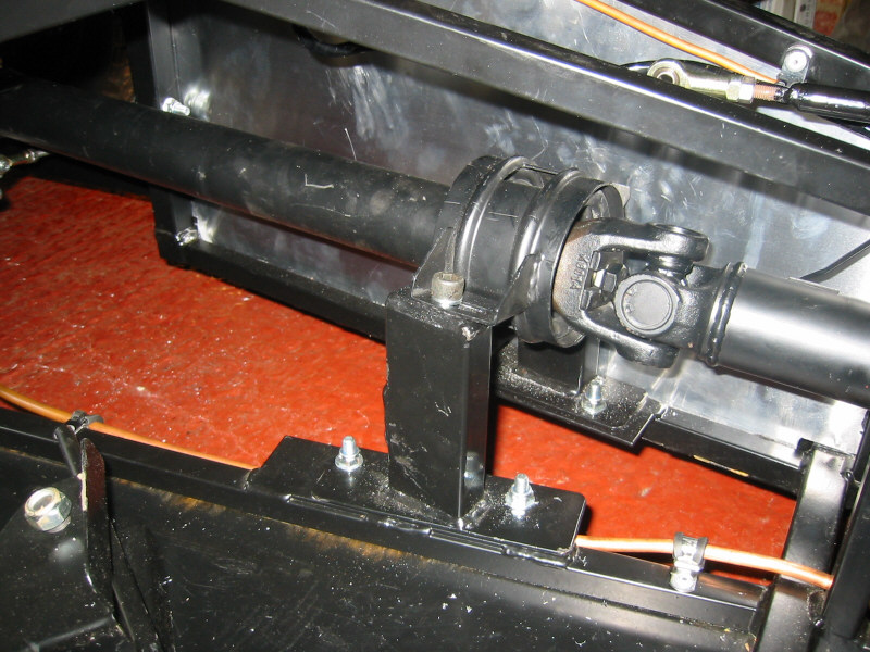

cheers for the info. my mistake, i did mean tt2 n tt3. so i can put a plate straight across from tt2-tt3. as some people tend to do this -
http://www.roebuck.eclipse.co.uk/pic...4-2476_img.jpg
Old 15th April 2010, 12:40 PM
Having looked at that picture you,ve attached then yes, I,d go for that, tho i personally would put the plate all the way across between the TT2 & TT3 tubes, to strengthen the mounting & avoid weakening the mounting bracket.
