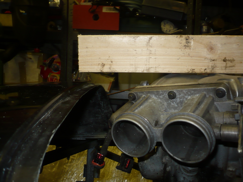

Having fitted my engine mounts, I find i have the engine a little high. I have the scuttle and nose in place ( temp ) and the engine is proud of the bonnet top line ( I need to dig out the bonnet to see if we are touching. )

No need to drag the bonnet out, why not use a batten/straight edge to span the gap between the nose cone & scuttle.
That will give you a good visual idea of what is going on under the bonnet & where changes could be made

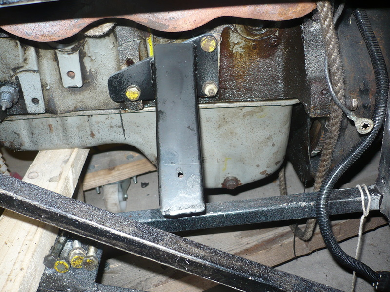

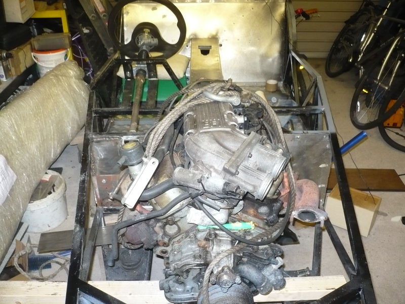

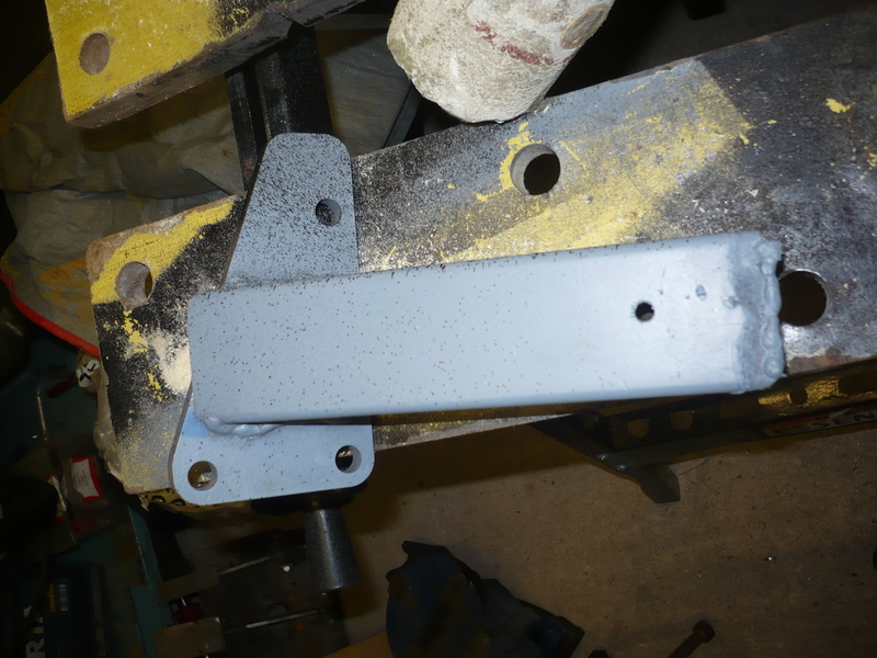

So First up, you can see the 2.9 sitting on the temporary wood, the plan was to get it sitting on it's mounts that I made up and see how high it was on the bonnet line.

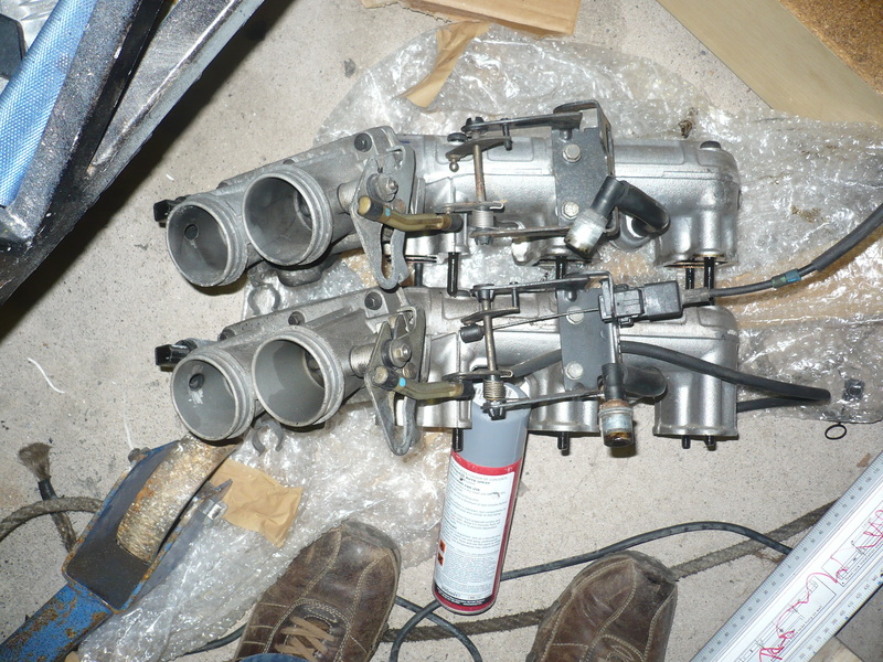

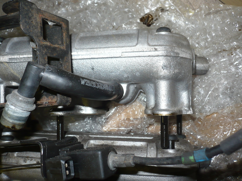

With that in place I could see the engine was too high, and the next plan was to get the shorter plenum and see how much difference it would make.
  #66
Old 20th February 2011, 09:20 PM

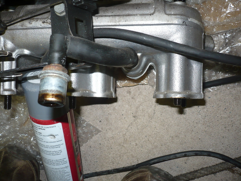

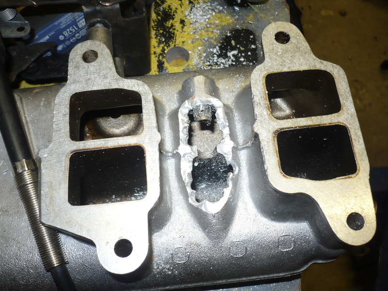

The shorter plenum has 2 problems, 1st there is a random block of alloy that was rubbing on the overflow from the thermostat. So that had to be cut away. 2nd, there is a bulge under the plenum for the balance port and PCV outlet. this rubs on the steel fuel rail, so this has been machined down a bit (still to finish it off) So the plenum now fits.
But the line is still too high. So I either get the engine lower, make a custom plenum, or butcher the bonnet.

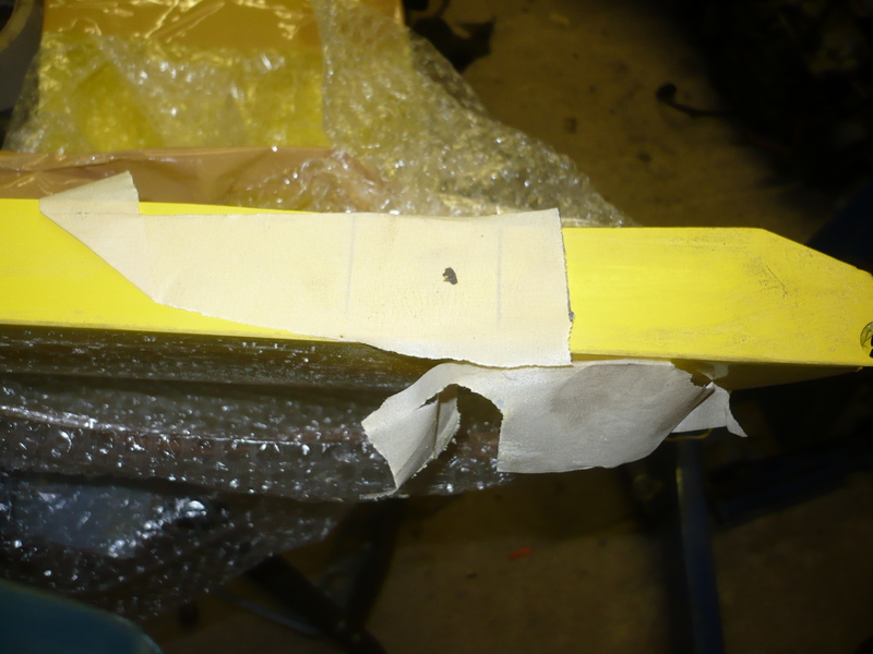

as you can see the bonnet is standing a bit proud, I fitted two bolts in to hold the nosecone, that's the first pice of bodywork started!!!!
Black and Zinc Yellow

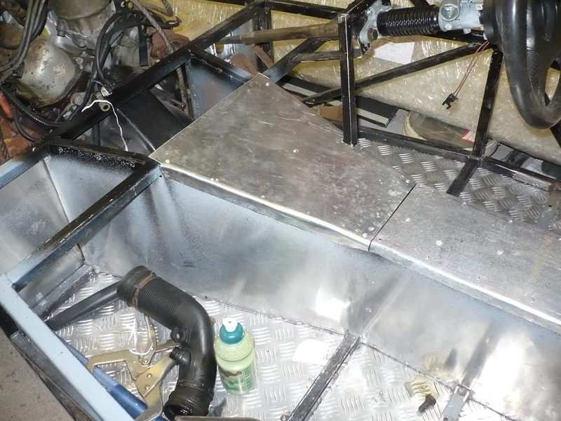

Interior Shots. This was done a few months back!!

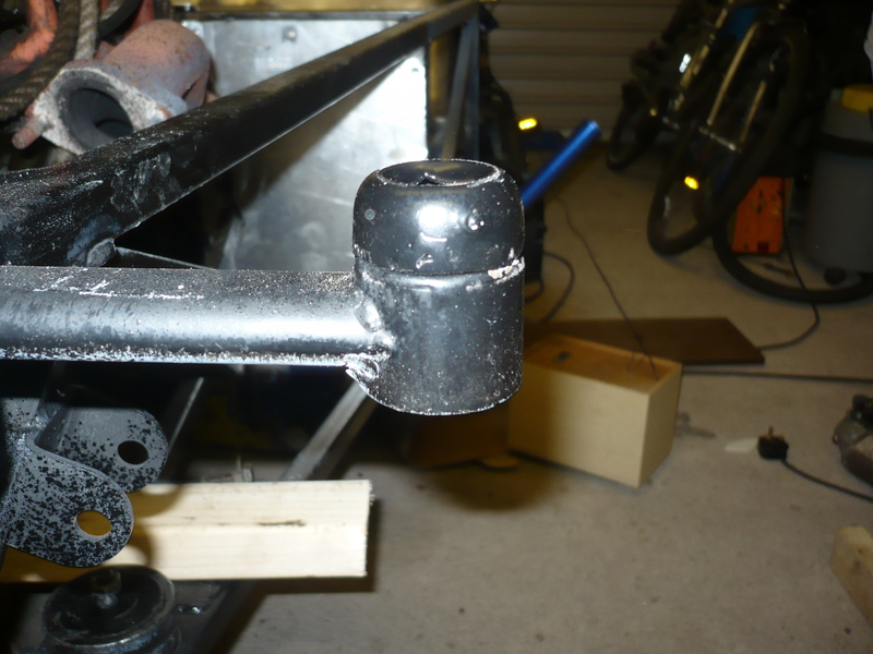

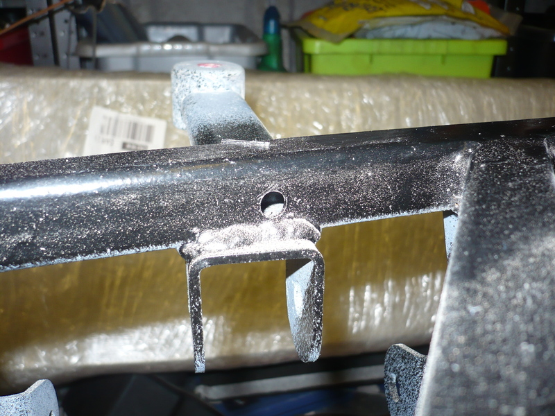

The headlamp supports with modifed headlamp mounting brackets ( they were far too large in diamiter for my small sized tubes.
And the holes for the wiring to pass through
I wana get this bloomin engine sorted before I decide to go for a different route!!
