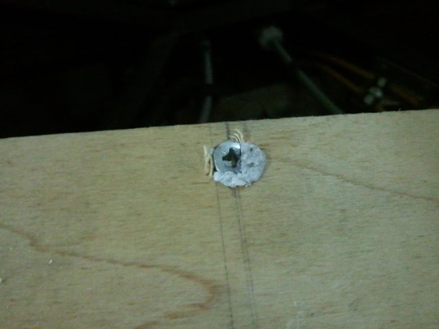

Old 17th October 2012, 08:59 PM
1st pair of t-nuts done, there will be a minor change of plan though.
trying to get the screws in from behind was a bit of a swine, so i intend to weld stud to the t-nut so that a nut will go behind instead.
the t-nuts give a solid fitting that should never break free with dismantling and reassembly.
so, some 6mm stud and a few more fixings to sort out....
