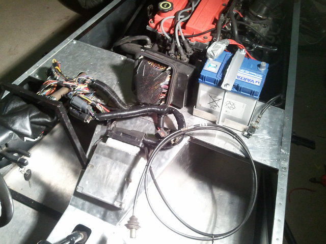

I got a 40Ah Japanese form factor Varta, it's perfectly sufficient, cost me about 40 pounds, and weighs just 10 kilos.

It's not like you'll ever have to start it at -15°C. And small batteries at normal temps perform like huge batteries at winter lows. IIRC Pinto's starter was 700W, not 700A. My CVH starter on a Zetec is rated at 1.2kW or 1.4kW, and I can crank for 30 secs without any sign of slowing down.
