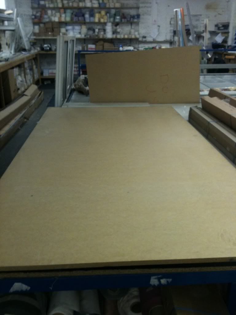

I'm building the chassis at my unit as there's more space, it's warm, lightings good and most importantly i've already got a solid work table to use.
The table i'm using is a roller blind table ( i manufacture/install window blinds) and the table was setup and bolted down perfectly level, so it's a good base.
I've attached a sheet of 15mm mdf and screwed it down tight so this will be the base.
Build area

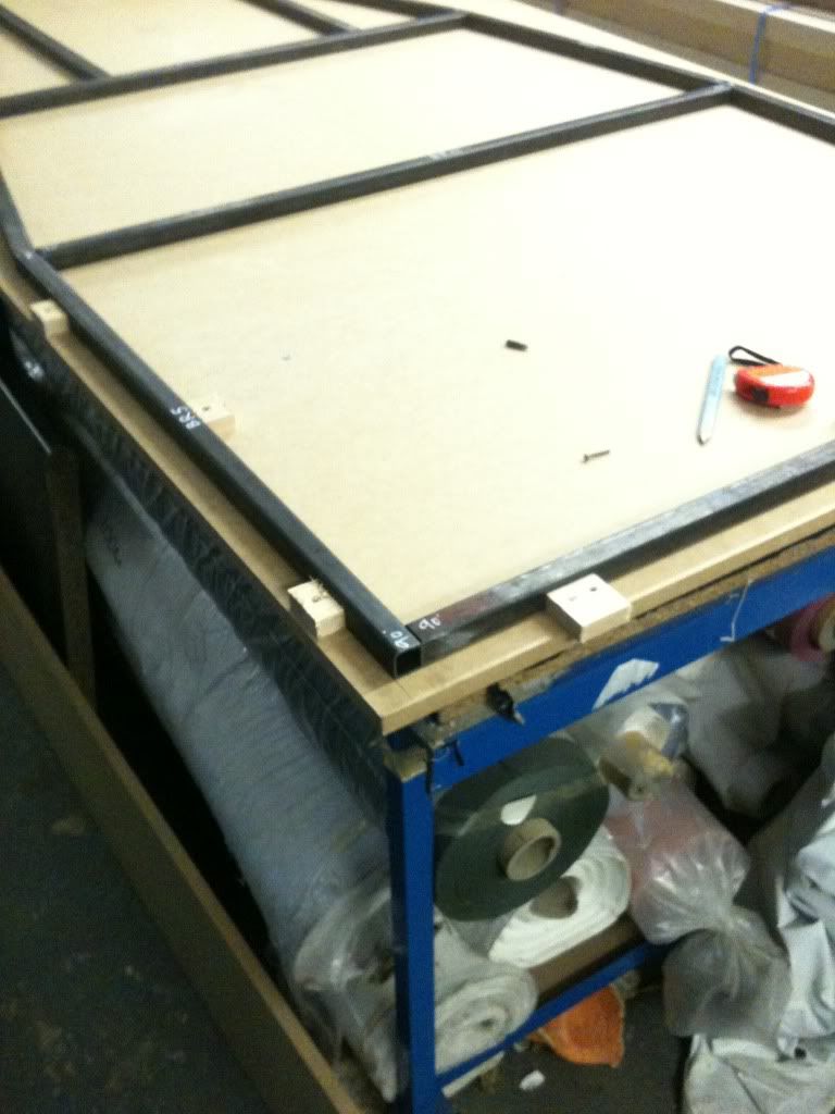

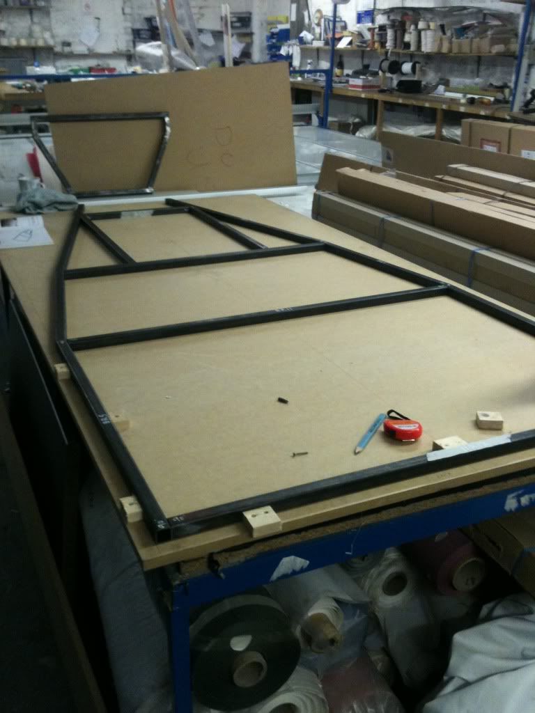

After unwrapping Andy's superb chassis pack i started to lay it out and get an idea of where it all goes, pretty quickly layed it all out and began to mark up the base board.
Laying and marking up

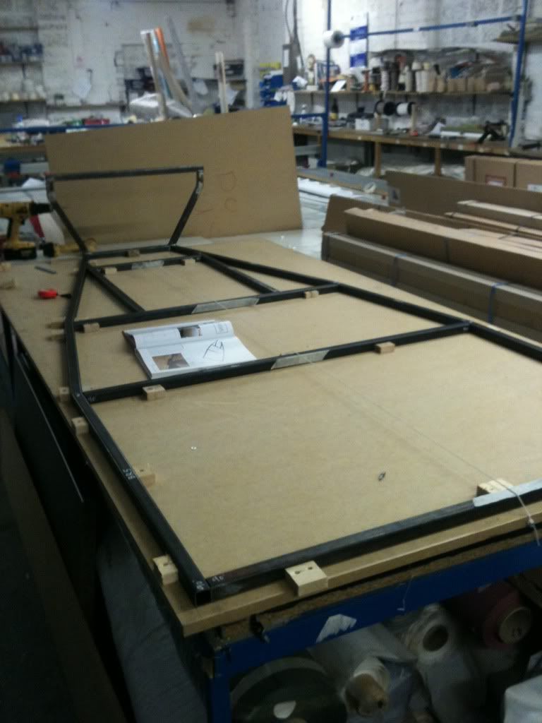

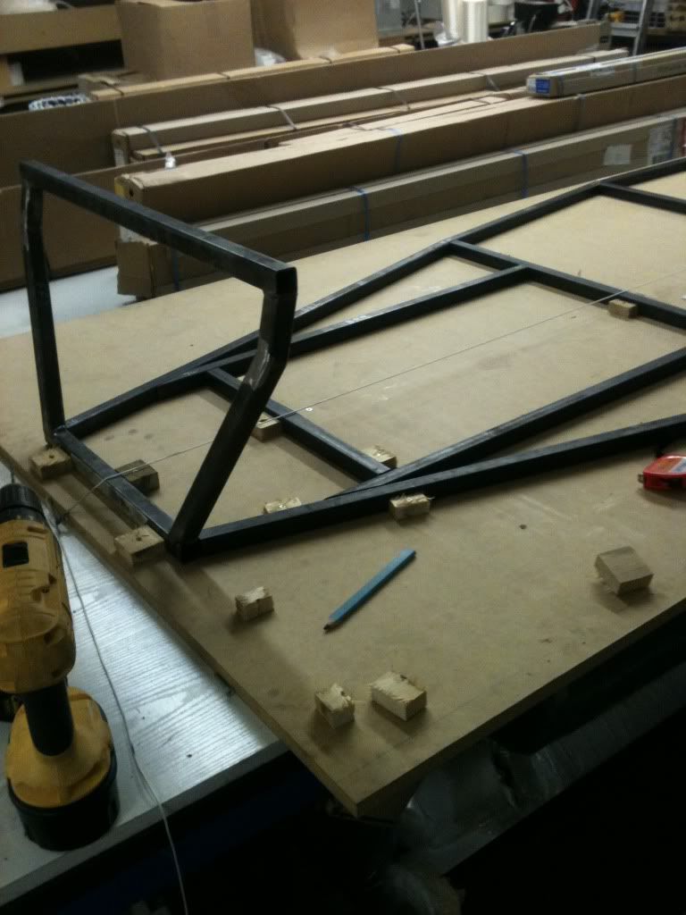

Eventually had it all marked and most parts blocked in, left it this evening with just two bars needing placing in.
Stage 1 under way,
Total spend so far £95

All going well so far, just need to check all the measurements and placings a few more times and i can begin tacking it together.
A huge smile on my face now i'm underway.
