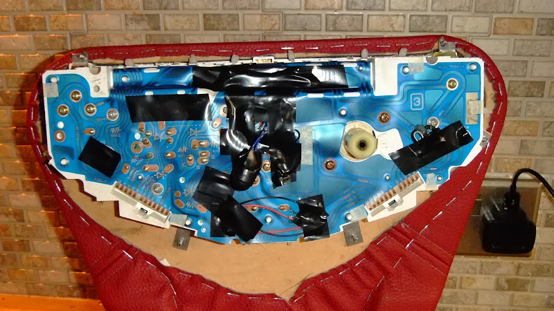

I have been fitting the LEDS to my dash recently. All of them worked well except the brake warning/handbrake light. It wouldn't go out when the handbrake was down, but a bulb would. I figured out it must have been the resistance across the bulb was causing a further drop of power that the LED wasn't creating so I added the bulb in parallel with the LED and the LED then goes of as expected.
I spoke to Skov about putting a resistor in there to create the resistance needed in place of the bulb but it worked out I would need one or two of those ruddy great big rectangular ones like you put in the indicator circuit when using LED bulbs so I covered the bulb with a bolt cover so it doesn't illuminate behind the dash and ill just leave that in there!
While messing around with the dash it turns out that the epoxy I used to hold my 'glass' to the bezels wasn't sticking to either the glass OR the bezels and they all fell apart so I had to come up with another solution.
I decided to try and hot glue them. Started off by keying the edges of the perspex discs and dabbing hot glue around the edges.
I keyed the inside of the bezel a little too and laid them down in position on some grease proof paper on a flat surface.
  #348
Old 7th November 2013, 07:43 AM
Then I got out a hair dryer and melted the glue and pressed the bezel into position.
This left some glue that squeezed out as you can see but some white spirit and a good rubbing action and you can get rid of the excess inside and out..
Seems a lot more solid than the epoxy versions and being hot melt glue it has just the smallest amount of give so should hold up to any vibration or flexing.
