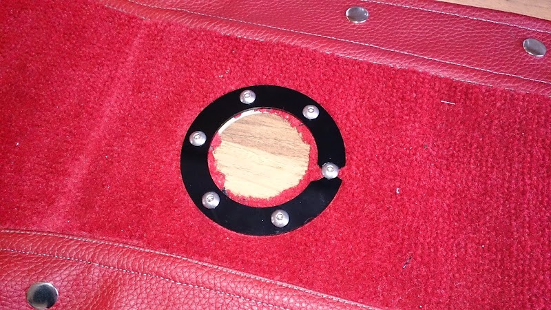

Gaiters are in place and work great. I also made up a covered rear panel for the tub.
The filler bracket will be covered red too.
