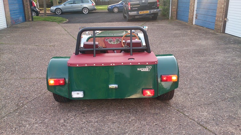

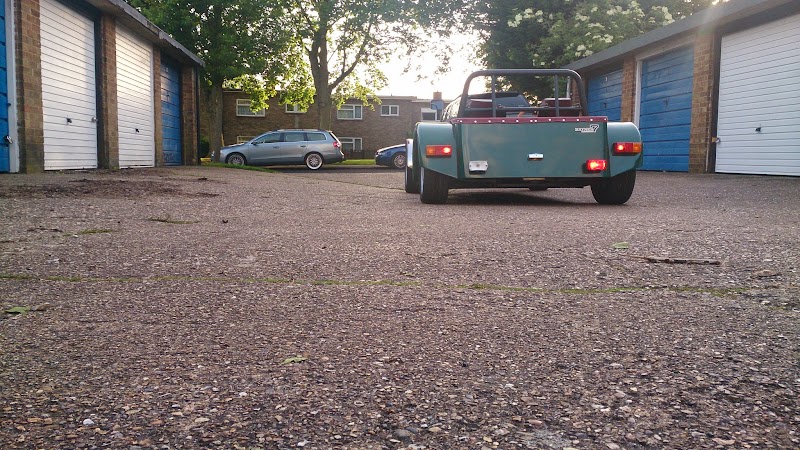

Heres a few current pics. If you spot anything suspect let me know!

looks pretty much the dogs John.....does not look like there are any issues re the photo's but when mr iva gets started you will never know until the large mama sings

Absolutely stunning
Only thing I can think of - does the handbrake need adjusting? It looks like it comes up quite high. When I sva'd my Robin Hood I got a failure point because the handbrake came up to near the end of it's travel or some similar wording. I had to adjust it so it only came up 3 clicks of the ratchet. the exhaust clamp may be an issue as well. Cant see from the photo but it looks like there may be a sharp edge on it. You would get away with it if it was below the level of the floor but it could be an issue where it is. If the bolt is hex headed and it can be done up by a spanner just rotate it so the adjuster bit is between the pipe and the body so they can't touch it with the test sphere. Hope that makes sense - it's early!
Best of luck with it, you have built something quite remarkable there, it's quite an inspiration.

Cheers guys,
The handbrake is only about 1/3-1/2 full travel. I have tried to make a new cable for it but mild steel weld blob on a stainless cable just breaks off when you put handbrake type pressure on it. Some argon and SS wire should do it though.
With the indicators they fit the style ive gone for, and when I fit clams after IVA that is where they will be so I think it works overall.
