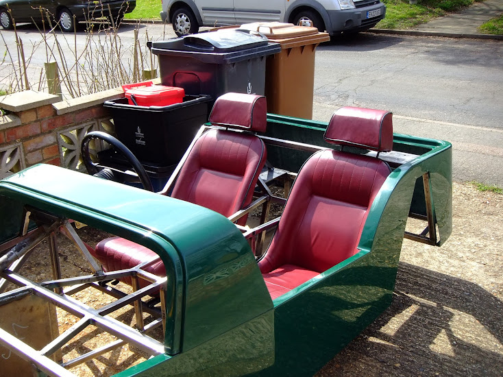

Took advantage of the sun today and made up the seat brackets. I used some 25x25x3 angle and welded the nuts to the bottom so I dont need to get underneath to fit or remove the seats.
The seats look great. and fit perfectly, even with the flared back section of the transmission tunnel.
I wouldn't recommend them for drivers taller than say 5'9". I'm 5'6" and the seat position for me is only 2 clicks forward from full back. Im gonna need a smaller steering wheel too!
