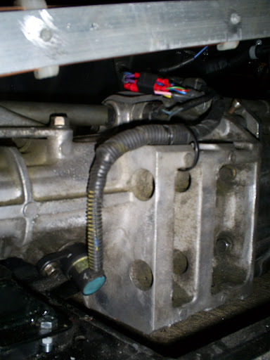

Looking good skov. How are you changing the speedo drive from cable to electric? I like the instruments you have chosen.
Thanks David. I've replaced the speedo cable with a speed sensor from a Mk2 MX5:
