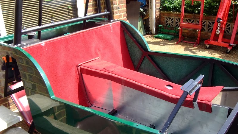

Looks cool Phil. The steering support is Sierra design though, the MX5 column mounts like this.
Old 30th September 2013, 12:06 PM
No thats the Saturn designed steering column frame which is not adjustable for either height or reach, the brackets which are not shown that are made for this mount allow the Mx5 column to do both.
