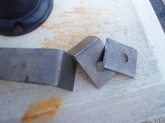

For those of you making your own suspension brackets.
Something to watch out for.
Using the same jig I used to make my first set of brackets.
And using the same type of steel, but from a different supplier.
As you can see they cracked by the bend.
I tried a different length, but the same thing happened.
I tried some of the original bracket steel, no prob's bent fine.
So beware of buying cheep steel, and check the bends for signs of cracking before welding them on.

Good point David
I have had strip steel do this sort of thing. Not often but the quality does tend to vary quite a bit
Probably safer to cut critical components from plate as the quality tends to be of a higher spec

What you probably have there is a strip cut from a hot rolled sheet. If the edges are a crisp cut don't even bother to try and put a 90 degree bend in it. We used to have this problem alot at the sheet shop and in fabricating uprights for various things. If in doubt go for 40x3 bright mild cost a fair bit more but at least it won't do that!

What you probably have there is a strip cut from a hot rolled sheet. 40x3 bright mild cost a fair bit more but at least it won't do that!
Thanks for that.
Bright mild was what I ordered, was a bit cheap though.

Not trying to be a smart arse,but steel that is folded has a grain just like wood and in the slabs before rolling it is marked by paint in the corner denoting the grain.It looks like fracturing across the grain and as Talon said probably cut from sheet and not a strip.
