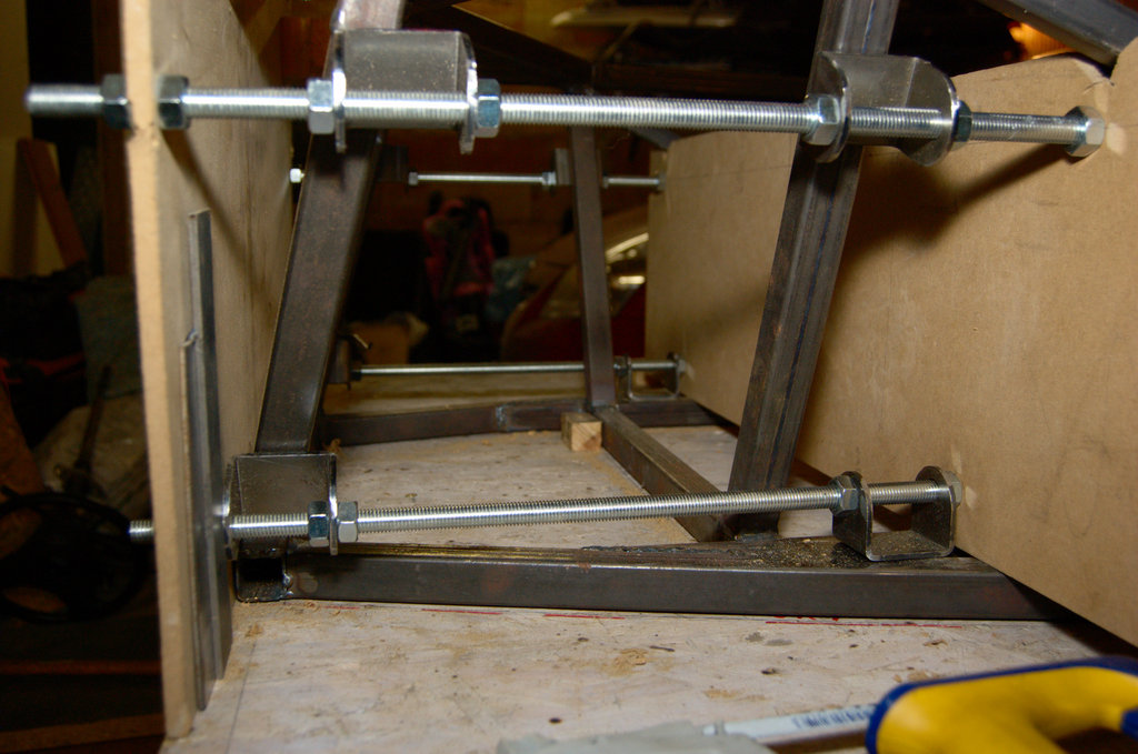

I used two pieces of MDF and a handful of nuts to hold the M12 threaded bar in place:
http://locost.lt/download/file.php?id=138&mode=view
