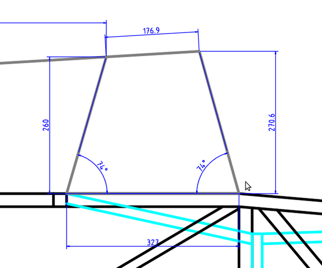

old_bill, you can find the basic proportions of the Saturn GRP scuttle here:
http://www.haynes.co.uk/forums/showt...?t=3578&page=5
Personally, I would make the scuttle continue the lines of the bonnet, so the rear would be about 1 cm higher than the front, something along these lines:

Hi Bill, it's more or less like Alga's diagram except I made mine slightly higher because of the height of my DOHC engine. The rest of the dimensions / angles were kept the same, my one was about 20mm higher than "standard"
