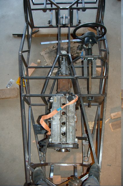

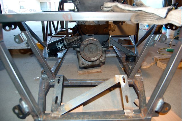

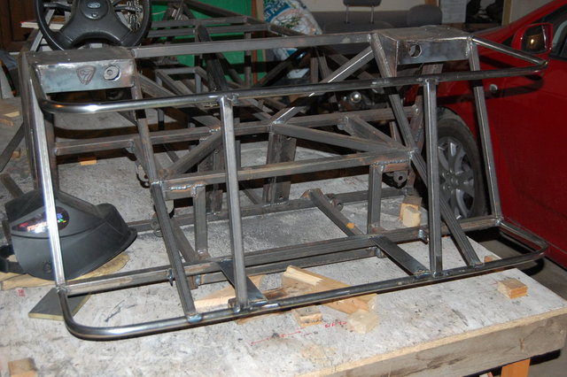

I have a chassis with all of the welding finished, suspension, rad mounts, etc. done:
The Zetec 2.0 engine and Type 9 gearbox are sat in place:

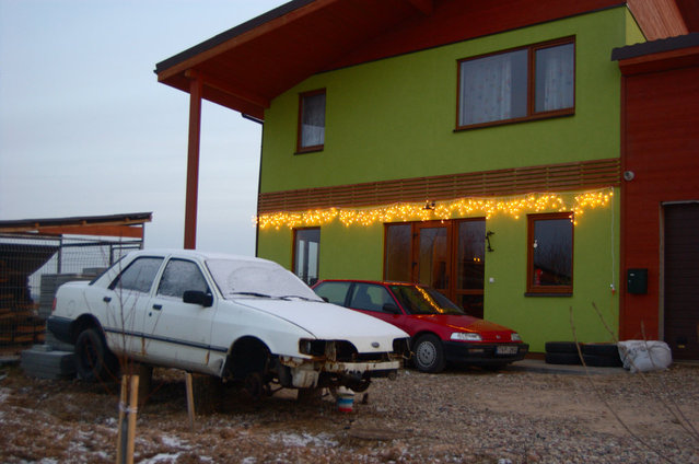

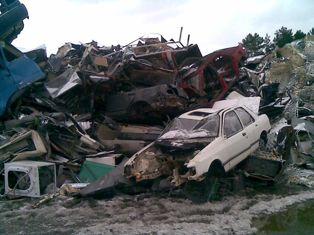

I bought a tired Sierra with the front already ripped. You can imagine how my wife was happy with this sight outside during most of the winter.

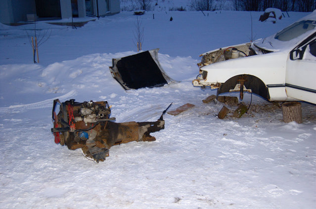

Had some fun tearing it down in -10°C temps this past winter. Not too bad when all the rusted suspension nuts keep you constantly working hard.
Eventually I scrapped the shell and got some beer money after the VAT, transport and deregistration costs were counted out

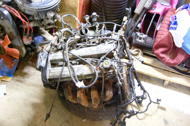

Initially I though of using the Pinto that came with Sierra
but later I was persuaded to use a Zetec. Either with standard pre-PATS ECU or MegaSquirt (I'm looking forward to all the soldering, electronics are fun)

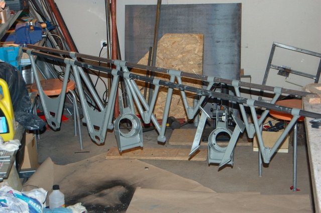

I have the suspension bits all fabricated, primed and painted by now.
And here's me working on the rear upright jig sometime in the spring, with a silly "Zappa" beard style. Good job beards grow back pretty fast

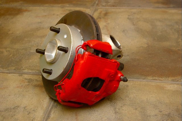

Oh, I had some fun with electrolysis on the front hubs and rear drums, too!
The driveshafts are still filthy, and they need to get clean pretty quick if I want to get to the rolling chassis stage!

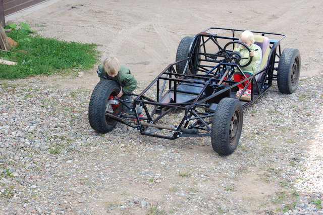

She's a roller!
Old 5th September 2010, 12:03 PM
That is looking great Albert
A huge moment of the build that's for sure
Still remember the day I rolled my chassis out of the workshop for the first time .... Wheels certainly seem to bring the chassis to life.
Looks like your little ones are having great fun
Keep up the great work, I love to see builds making progress
