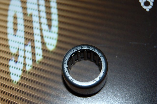

The spigot bearing in the end of the crankshaft for Zetec RWD conversion is HK 1516.
