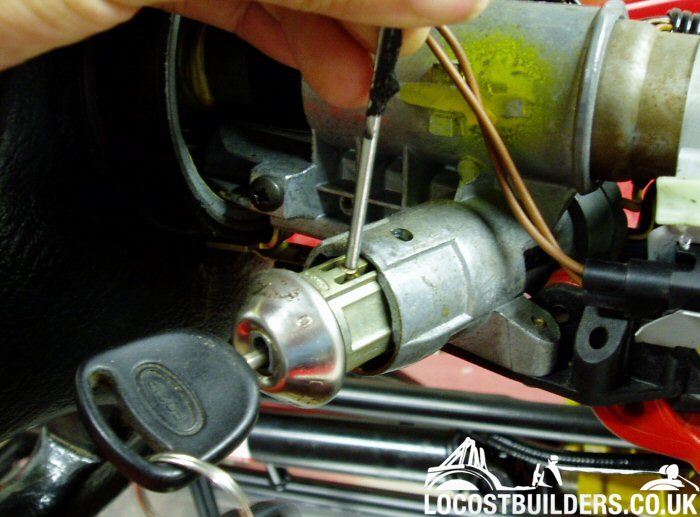

hi guys,
it seems my key was eaten by the vast pile of crap in my shed, so i have just bought a replacement ignition barrel with keys, however i cant figure out how to get the old one out. Is there a special way or do i just get medievil with a lump hammer and cold chisel?

Put key in,
Turn to position 1
Press small silver dimple on underside of lock barrel ( via hole in lock barrel holder )
Pull out .
Now, as you have fallen at point 1, you need to very carefully drill the dimple with a strong drill bit.

Turn the key to position 1 and use a rivit to push the detent...
Then out it pops and you can see the detent that holds it in.

kind of defeats the fact that hes already got the new lock set that cast bit that the barrel is in can be removed from the column. i would take it off put it in the vice and smack the hell out of the retaining pin using a hammer and punch.
failing that screw a slide hammer into the key hole and draw it out thats what we used to on the old farm transits so they didnt need keys.

You need to cut down between the barrel and the housing effectively slicing the shiny end off cleanly, then the tumblers will just pull out and you can turn the lock & remove as normal, I.E. turn to the position to release the little plunger.
You can do this with a normal hacksaw blade easily, an air saw is even better but use a thin blade to avoid damage to the housing too much.
THis was common practice when I was in a Ford main dealer, sometimes with several air lines coupled together to reach the car in the car park !!!
