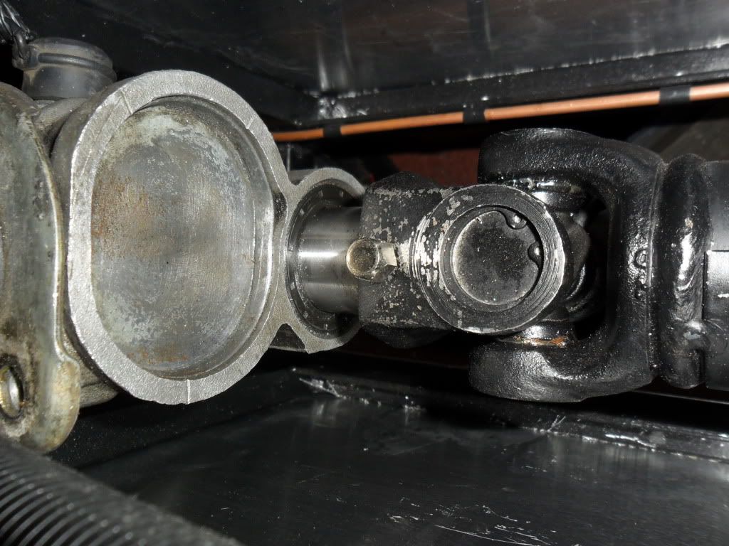

Ya fair do's guys, it sounds like a better plan to just get a new one delivered from these guys. At least it'll be uprated too which is doubtfull from the local guys here. Newbie question though, wheres the oil seal on the gearbox so I can take the measurement?

Old 15th September 2011, 04:42 PM
The oil seal is the black rubber seal where the prop goes into the gearbox, see picture below.
