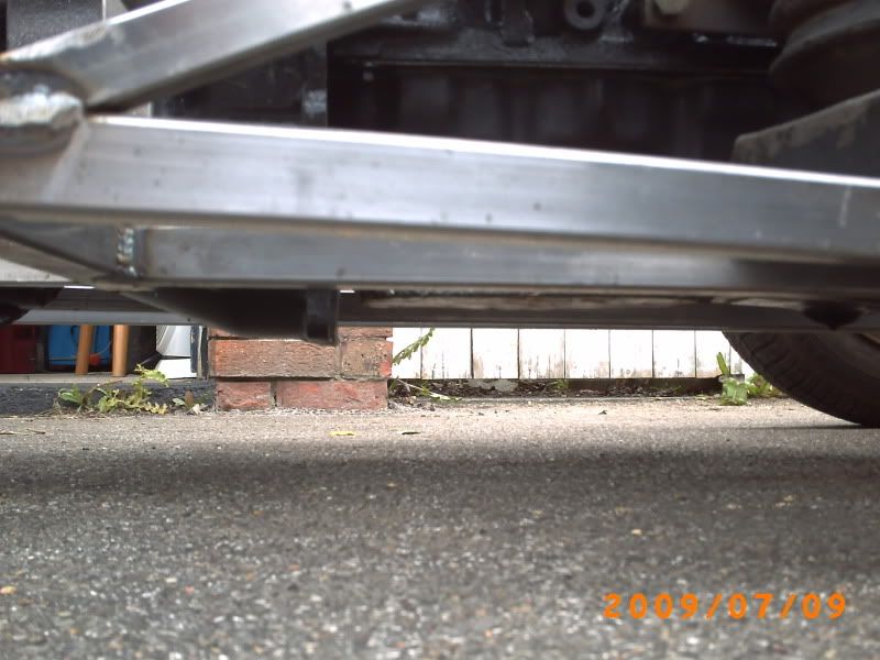

I presume you are using the Type9 gearbox? if so then the bottom of my bell housing sits 25mm BELOW the bottom rail of the chassis, I think a few ( probably most ) builds are like this , maybe if you lowered the engine/box by 25mm it would solve the height problem for the bonnet?
Sorry I don,t know for sure as I didn,t use the Pinto.
Old 4th October 2011, 12:36 AM
here,s a pic showing the bottom of my bellhousing in my chassis
Hope it helps.
