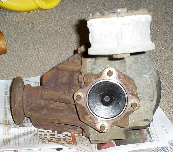

ive not hauled my diff out yet, but is there any pics of them, would it be possible to weld in some 25*3mm flat in line with the inboard ends of the diff mounting plates, meaning that the diff mounting holes would be 3mm recessed, but would add the required rigidity?
just an idea....
Stew
Old 5th February 2012, 08:59 PM
Here's some pics of my 1.6 diff if it helps Stew:
