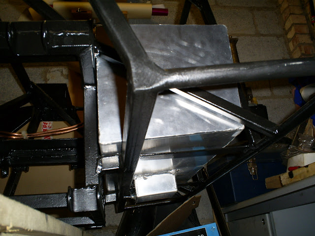

If you're worried about fuel slosh, it's common to weld in baffles and add a pot on the bottom to take the outlet from like Kev did on mine:
