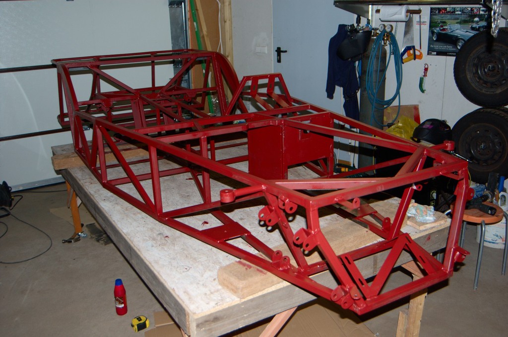

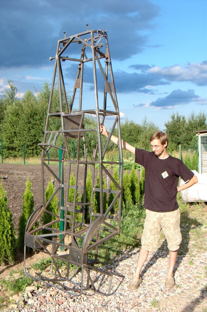

I made a recess in the top rail for the thermostat housing. This way everything fits nicely.
Bigger: http://locost.lt/download/file.php?id=351&mode=view
Another pic: http://locost.lt/download/file.php?id=350&mode=view
