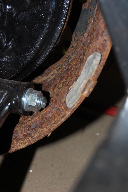

14 inch steelies fit, but only just.
you need to get a lock nut on there as well so its mega close and if you have a flat in the rim it will touch
as for ride hight i feel the need to point out that if you fit bigger/smaller rolling radius tyre/wheel combo's you want to ajust the ride hight figure the same amount just as if you put the std wheels on, set the hights then, changed the wheels over
i hope that makes sence
